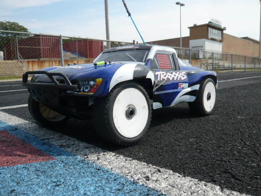

Yep, once I have the dough I'm going to buy a 17mm hub conversion and some on road tires that won't baloon out.
--Loading...Please Wait.--
 Post Posted: Sat Sep 05, 2009 7:07 pm
Joined: Tue Dec 02, 2008 7:00 pm
Posts: 15
Location: Chicagoland IL
I had a set of old pin tires, so I'm running them until I can pick up some street treads. They hook up real nice on rubberized running track.

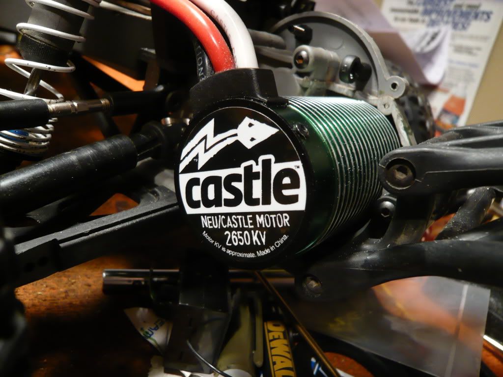

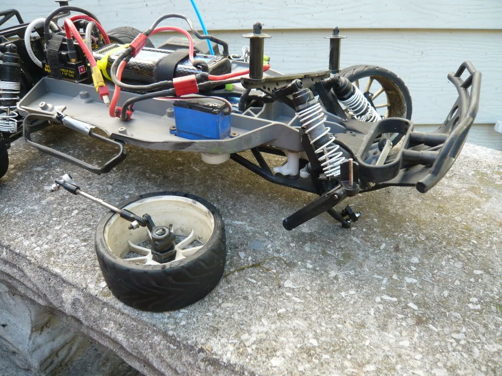

It's been a while since this has been updated....
Got it set up with 17mm hubs, made by STRC.
Hit a fence making a speed pass at, oh, say...45+mph.

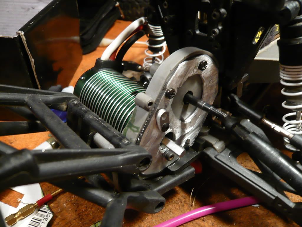

The force of the impact practically destroyed the sad little Nemesis Blue motor, which was on it's way to burning out. 3s is the limit, but I ran it at 4. Oh well! I decided to step up the power and get myself a new, far superior motor.
Yes, I went big. E-Revo VXL power big. Mamba Monster 2650KV big. It took a bit of creativity to get it in, but it's mounted up nice and solid now.
...ok it took alot of creativity. I had to open up the space for the motor to mount, grind the fins down in one place, and make a 3mm thick aluminum plate for the motor to bolt onto. Because the shaft is in a different location from stock, I'll need to run to the LHS tomorrow and get some new gears.
Can't see them very well, but I've installed the Traxxas steel outdrives to help handle the power.
